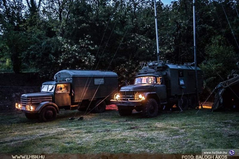

R-134 russian military transceiver – HA9HAF9A and HA7AA Hungarian Army amateur station Szentendre, NCO Academy (Blok-12 It’s over) (HA5CBM)
